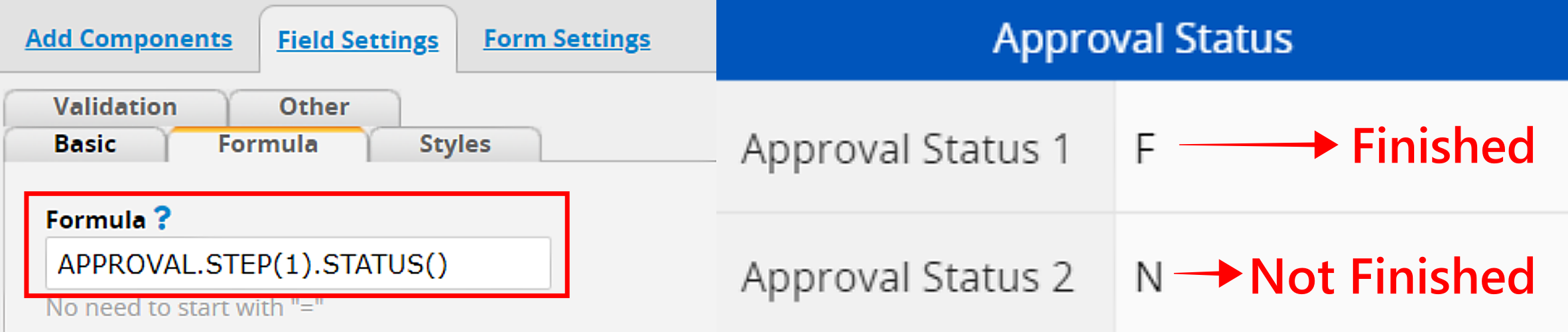

2. Add two fields to display the approval status of different steps
To help the system distinguish which step of the approval process we are in, we will need to add two fields and apply the approval formula to display the approval status.
For example, if the approval process consists of two approval steps, we can add fields I2 and I3, and apply "APPROVAL.STEP(1).STATUS()" in the formula setting in I2 and "APPROVAL.STEP(2).STATUS()" in I3 to display the status of first and second approval steps. The approval formulas will return "N" when the step is not finished, and "F" when it is finished.
3. Add another field to check whether the statuses of the approval steps are the same
After adding the two fields in the previous step to display approval statuses, you need to add another field to check whether the statuses of the first and second approval steps are the same.
For example, you can add a new field I4 and apply the conditional formula IF(I2.RAW = I3.RAW, 'Y', 'N') to it. If both I2 and I3 are "N" or "F", meaning both steps are either unfinished or completed, the formula will return "Y". If one step is "F" and the other is "N", it will return "N".
